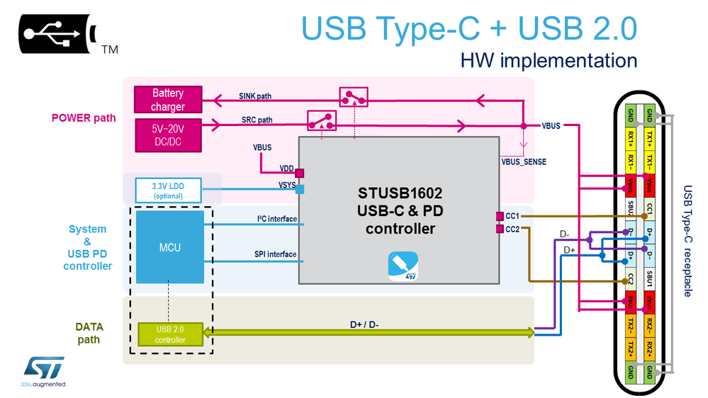

Hello!
i am trying to pair a nordic nrf52 mcu with the stusb1602 throug a usb c cable but i would like firmware upgrades on our upcoming product to go through the usb 2 protocol too and i have no clue how to pair the usb c an the controller
hope to get some answers. Im new to this

With the USB Type-C specifications, the Data path and Power path are independent.
That means:
- The USB Type-C controller manages the cable connection/orientation and Power negotiation. But not the Data.
- The USB 2.0 controller manages the Data (on D+/D-).
The USB Type-C didn't change anything to the USB data path. So you can use a USB Type-C controller with any legacy USB 2.0 controller (or USB 3.x controller).
The Hardware implementation to have USB-C with USB 2.0 data is described on the attached block diagram.
* Firmware Upgrade:
In your case, where you would like to have the Firmware Upgrade (DFU), This feature will be managed by the USB 2.0 controller (as it has always been managed), but not by USB type-C controller.
So any software that you had available for your USB data controller with a legacy cable will still work the same way with a USB-C cable. Because it is the same D+/D- pins which are used for DFU.
Best regards.
