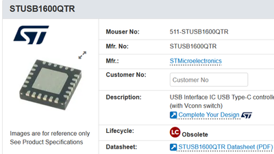

I have questions about the STUSB1600:
1. Mouser marks the device as "obsolete". What is the EOL of the STUSB1600 and what alternative is recommended (STUSB1700?)?
2. The STUSB1600 is connected to the MP1 via I2C. I need to program the NVM "in system" with custom values but did not find / missed the information (in the datasheet) on how to do so. Any Idea (apart from the external programming with this NUCLEO board)?

Yes, exactly. I Wonder why Mouser sets it to obsolete....
EOF
Ah I see: The STUSB1600QTR is "obsolete" but the "STUSB1600AQTR" is not!
Thank you for the clarification!
But I linked to the AQTR version. There's the difference.
NBALL
Hello
1- STUSB1600AQTR is the valid reference (stusb1600qtr has been replaced by this one since long time). This is the reference used on MP1 board.
2- To program STUSB1600 in system, stsw-stusb004 can be used as example.
Best regards
Nathalie
