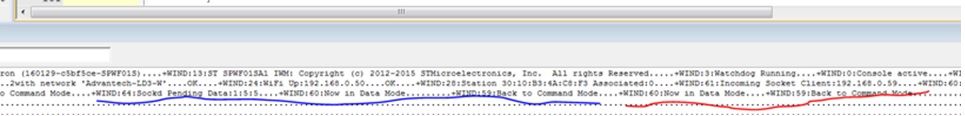

We are trying to reach real-time 50mS per round trip of 20 byte TCP messages of receive and then send response. I'm actually seeing closer to 150mS round trip time. Much of this time is taken up in switching between data and command mode. Our measurements indicated 88mS or 44mS per side. Switching to command mode requires the following characters Tx:'at+s' and Rx:'+WIND:59:Back to Command Mode'. At 115,200 bps that's 0.00295sec at 10 bits per char which is 6.8% of 44mS delay. What is the other 93.2% of the delay time? How long should it take to switch from data mode to command mode? This appears to be putting excessive overhead on our message traffic?

The issue is not related with socket timeouts. The SPWF module is commanded to switch to data mode by the ST Middleware AT command 'at+s.' and some time later (i.e.44mS)  the confirmation '+WIND:59 Back to Command Mode' arrives to the middleware. If you examine the ST Middleware ASCII traffic it switches between data/command mode for every TCP message read/write in the 'SOCKD' mode. This switching between data and command mode slows the TCP round trip (RT) traffic dramatically.

The problem is not an issue with the ST Middleware as it is slow switching times in the SPWF module between data and command mode in SOCKD mode. This picture shows in blue a TCP message receive and red a message send. The switch time total is 88mS for a 20 byte message.
