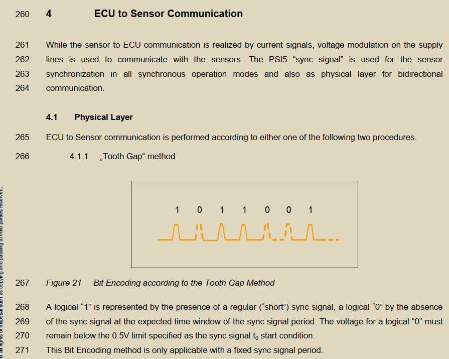

PSI5 ECU to sensor Communication like this:0693W00000SvsGnQAJ.png But I cannot generate this waveform via L9663 ——no matter how I configure the registers.
How to configure L9663 registers to generate this waveform via spi or pin?
