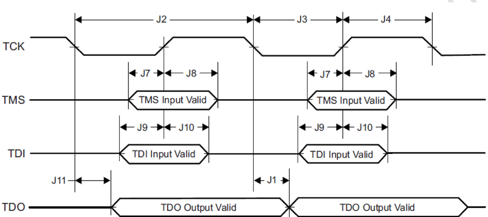

 Take a look on the JTAG timing diagram, J1...J11's are the parameter number.
