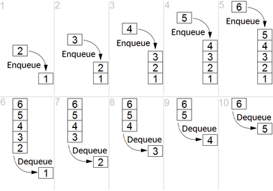

The CH1_CR1 (and CH2_CR1) register also has synchronous and asynchronous operation mode. In asynchronous mode, the data buffer operates in FIFO mode (When a slot is read/cleaned, it becomes available for other data to be received). So it has two interrupt modes per full data buffer (it has two ways to fill the data in the data buffer):

Fifo_queue
https://en.wikipedia.org/wiki/FIFO_(computing_and_electronics)
Perhaps it's just not possible to use DOUT as an interrupt (in synchonous mode) when only one out of three configured timeslots are used, since "all buffers configured by SPI" will never be filled with data.
