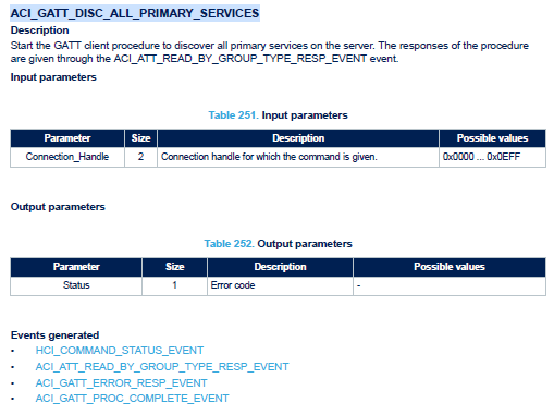

I am suppose to check disconnection_complete_event as well? I haven't looked at it since it wasn't mentioned here (see image).0693W00000Kc4rKQAR.png

Hi @LCata.1​ ,
Yes, this disconnetcion_complete_event inform you about disconnection ( whatever server or client side - it also gives you reason code for disconnection)
I'm not saying it is root cause but If a disconnection happens for any reason, there is a risk you are calling aci_gatt_disc_all_primary_services with invalid connection handle (because of disconnetcion)
