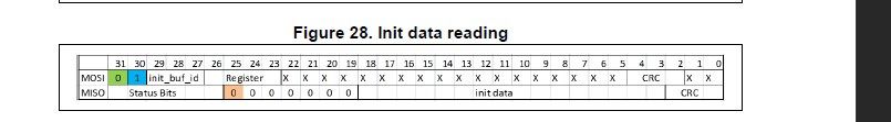

How to access the Init buffer in PSI5 ASIC L9663? Can someone explain how to make use of init communication frame for reading the init buffer?
ARK
During the initialization process , the phase 2 data, the IDn and data blocks Dn of incoming sensor data is stored in "init buffer id (init_buf_id)" of the corresponding frame id at address n-1.
I need more details on how to make use of the communication frame for init data reading.
What does "init_buf_id" and register refer to in the following below image shown.

in the image, "init_buf_id" identifies the init memory buffer which corresponds to frame control from incoming sensors data; "Register" is the address in which MCU can read init data content for the related memory buffer at the specified block ID .
The storage is triggered only on demand through READ_INIT_DATAx bits in CHx_CR1 registers and SPI access can start after init_data_rdy is set.
