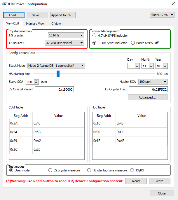

Hello, I have a Bluenrg-ms connected to a STM32 for the Bluetooth connectivity. How can I set the Bluenrg to use either a 32MHz or 16MHz external crystall oscillator? Thank you very much

Please use BlueNRG GUI, "menu | Tool | IFR/Device Configuration" to config accordingly.
https://www.st.com/content/st_com/en/products/embedded-software/wireless-connectivity-software/stsw-bnrgui.html
