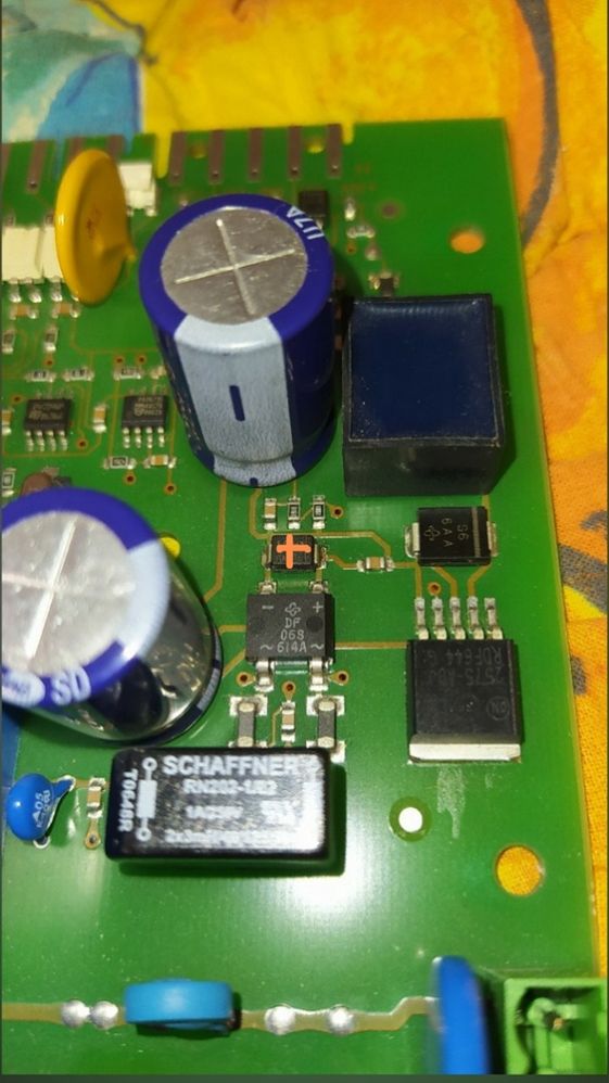

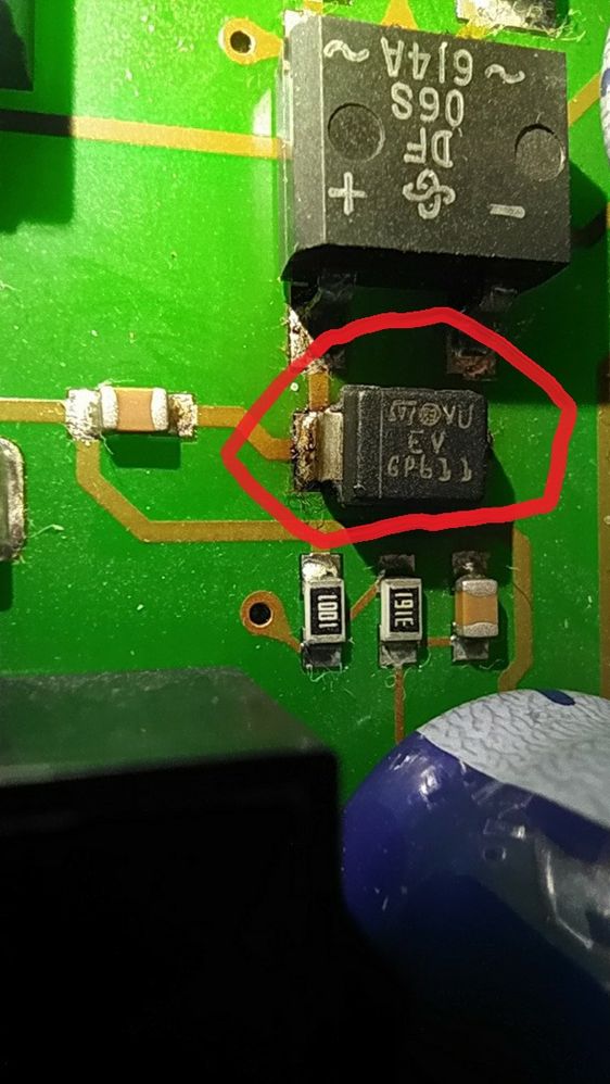

Comrades, hello maybe you know, what is this element on the board?
how to replace this element.

Figure it is the same EV diode, not sure ST has others using same codes.
https://community.st.com/s/question/0D53W00000MBzdGSAT/st-eevc518andst-eevc612the-board-stopped-working-after-a-power-surge-how-to-fix-it-how-to-replace-these-elementsthe-inscriptions-arest-eevc518andst-eevc612
Looks like it is supposed to be a flyback diode for a relay or other inductive load

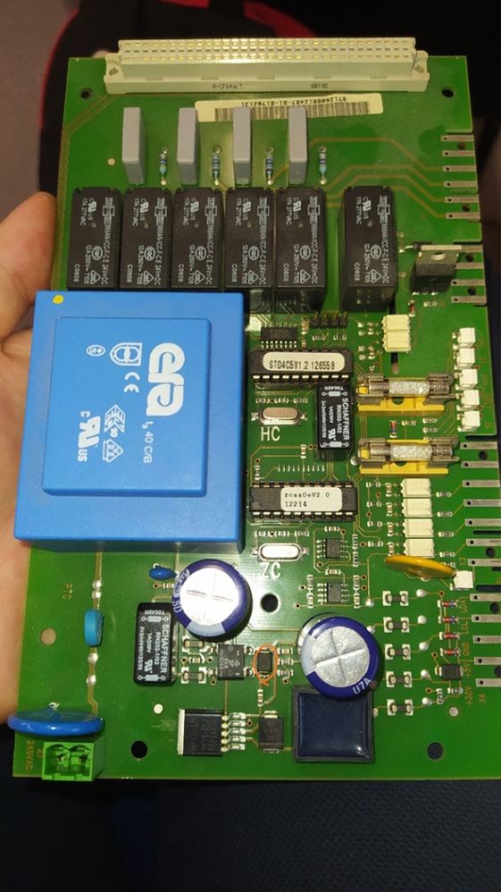

I will send you an electronic board, this "unknown" diode comes after Semiconductor Diode. Maybe this si really a flyback diode?
