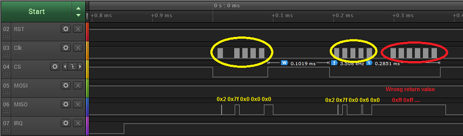

I am using BlueNRG ver 2 device, I'm using not an ST MCU, but freescale's.
SPI was porting to my MCU Kinetis and the issue is:
Instead of getting the ''Blue_Initialized_Event'' (0x04, 0xff, 0x03, 0x01, 0x00, 0x01),
I'm getting (0xff, 0xff, 0xff, 0xff, 0xff, 0xff).
The first 5 bytes SPI are OK and the second 5 bytes are also OK.
(the Bring UP is according to ''Bringing up the BlueNRG and BlueNRG-MS devices'')
attached waveform to describe the SPI signals.
Thanks in advance,
Guy

Dear Guy,
Which bytes are you sending on the SPI header?
The first byte must be 0x0B, which means a read operation.
Instead, if the first byte is 0x0A, this means a write operation.
Best Regards
Salvo
guy
Posted on December 09, 2015 at 10:07
Thx, it helped
