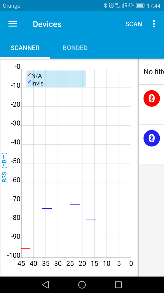

I have the same problem. Here is a screenshot from Android phone. The dark blue line is BlueNRG-MS visibility. There were no connections made. It's not a problem with visibility after disconnection.
