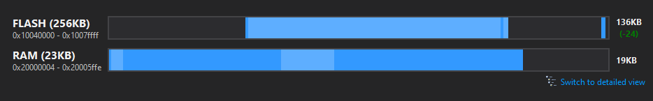

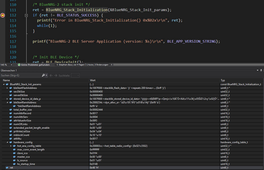

I'm trying to get the Bluenrg m2 module working. For this I use a code based on the chat demo. But when calling "BlueNRG_Stack_Initialization" I get the return value 0x48. If I am right, this means BLE_STATUS_OUT_OF_MEMORY.
For details please see the Pictures...
But from my point of view the memory areas and sizes seem to be correct. Am I missing something?

This error may appear when you forget to define BLE_STACK_CONFIGURATION and BLUENRG2_DEVICE constants.

And the Prerocessor Macros:
BLE_STACK_CONFIGURATION=BLE_STACK_FULL_CONFIGURATION
BLUENRG2_DEVICE
I think it's all there. It's based on the Chat demo.

Yes I did but it was long time ago so I don't remember exact steps. I only remember that I started from changing to BLE_STACK_BASIC_CONFIGURATION and it removed an error at the beginning so I could examine the code by debugging and turning on functionalities one by one. Eventually I use BLE_STACK_FULL_CONFIGURATION without any issue.
