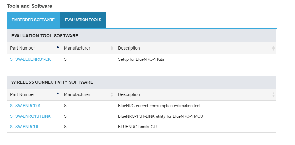

You may refer to the User manualsand related Tools/softwarein the
http://www.st.com/content/st_com/en/products/wireless-connectivity/bluetooth-bluetooth-low-energy/bluenrg-1.html
The BlueNRG GUI is available in
/external-link.jspa?url=https%3A%2F%2Fmy.st.com%2Fcontent%2Fmy_st_com%2Fen%2Fproducts%2Fembedded-software%2Fwireless-connectivity-software%2Fstsw-bnrgui.license%3D1487062354html
Hope this helps you.
