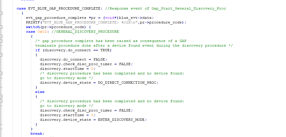

I have checked the project BlueNRG-MS_New_Chat from the BlueNRG-DK and I saw something strange in it.
It is said that Procedure Complete Event proc only when a GAP Terminate is done. So nom I'm a bit confused.
Could you explain me that ? I will share the project here.

I did some tests of my own and the behavior of my scan is really not good. The init goes well but after 5 adertising reports it stops when it should continue until its timeout. I should point out that I have a custom board with an MSP430 processor.
I was able to test a Nucleo64 evaluation board with the IDB05A1 module with the Blue-NRG Gui interface and the scan behavior was normal.
I don't understand what could make the scan behavior change so much, knowing that I'm using the same BlueNRG stack in both cases (x-cube-BLE1).
