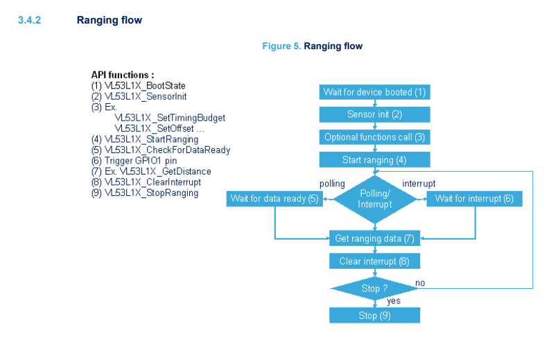

Looking at the "Ranging flow" diagram (in UM2510),
if I'm using "VL53LX_SetDistanceThreshold" with detection condition to be "Object within a window",
Do the interrupt triggers when an object comes within the window?
Or does the interrupt triggers Autonomously ?

So to answer your questions:
You will get the interrupt after the range occurs with an object within the threshold window
Or does the interrupt triggers Autonomously?
The sensor will run completely autonomously giving an interrupt only when your thresholds are met.
