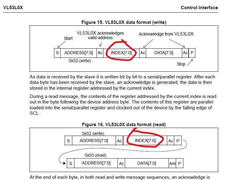

Is it possible to use VL53L0x without X-NUCLEO-53L0A1 extension board, directly connecting to my F302R8 board via I2C? HAL functions(HAL_I2C_Master_Transmit or HAL_I2C_Mem_Write) don't work and all i found is device address 0x52.
BTopb.1

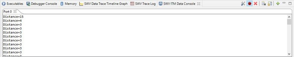

0693W00000BZq6tQAD.jpgMy code and console are as presented below. Values are on the console are fixed, they don't change even if i move an object in front of the sensor. Also i dont understand what should i put in "index" byte that is shown in data sheet.

	  	  ret = HAL_I2C_IsDeviceReady(&hi2c1, VL53L0_I2C_ADDR, 1, HAL_MAX_DELAY);
	  	  if ( ret != HAL_OK ){
	  		  strcpy((char*)buf,"Error adr\r\n");
	  	  } else {
	  		  ret = HAL_I2C_Master_Transmit(&hi2c1, VL53L0_I2C_ADDR, buf, 1, HAL_MAX_DELAY);
	  //		  ret = HAL_I2C_Mem_Write(&hi2c1, VL53L0X, reg, 1, buf, 1, HAL_MAX_DELAY);
	  	    if ( ret != HAL_OK ) {
	  	    	strcpy((char*)buf,"Error tx\r\n");
	  	    } else {
	  	    	ret = HAL_I2C_Master_Receive(&hi2c1, VL53L0_I2C_ADDR|0x01, buf, 1, HAL_MAX_DELAY);
	  //	    	ret = HAL_I2C_Mem_Read(&hi2c1, VL53L0X, reg, 1, buf, 1, HAL_MAX_DELAY);
	  	    	  strcpy((char*)buf,"Error rx\r\n");
	  	      } else {
	  	    	  distance = buf[0];
	  	    	  sprintf((char*)buf,"%u \r\n",(unsigned int)distance);
	  	        // Send out buffer (distance or error message)
	  	    		HAL_Delay(500);
	  	    		printf("Distance=%u\n",distance);
	  	    		HAL_UART_Transmit(&huart2, buf, strlen((char*)buf), HAL_MAX_DELAY);

It is quite possible to connect the satellite board up to any STM32 - or in fact, any MCU or CPU that has an I2C interface.
But the problem is that you are talking to a very complex sensor.
It's so complex that we don't give you the register map. I'm not going to tell you that you could not write your own code, but if you did, it would take so much work that you'd end up hating ST for the rest of your life.
So, download the API. It's free from the ST web site.
STSW-IMG005
VL53L0X API (Application Programming Interface and documentation)
There is a user manual in there.
And it will only take you a few calls to get it running.
But there is one trick.
The API ends with calls like RdByte, and WrWord.
So you get the pleasure of connecting these calls to the MCU's calls (like HAL_I2C_Master_Transmit).
You do this by re-writing the platform.c layer.
Or you can search GitHub and just download it.
