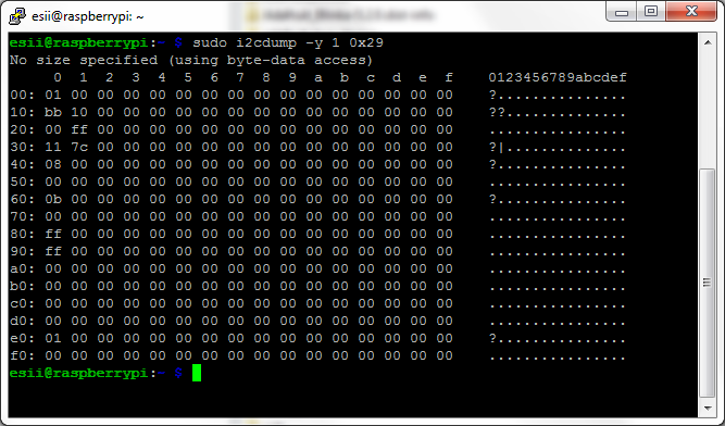

Thank you for the program, but I still can't use the sensor.
The vl53l3cx is detected at 0x29 address but I don't understand why the result of i2cdump doesn't provide the right Model_ID (0xEA) and Module_Type (0xAA)
I tested it with two eval boards "VL53L3CX-SATEL": result is the same.
Do you have any idea about this behaviour?

It's odd that I've never tried an i2cdump command. There are thousands of registers on that chip and I suspect you would find the EA somewhere in there somewhere. In our previous chip (VL53L1) it was at address 0x111. But there are pages, and the ID is on the NVM page and not in the RAM page you are looking at.
The fact that you got a response from address 0x29 means you have correctly hooked up the sensor.
Oddly you can run the L1 ULD driver code on an L3 - It will NOT give you very good values, but it will run and return a somewhat accurate answer.
run the code I sent, plus the ULD and you should get some numbers.
Then use the VL53L3 driver and the same main.c
It should work and give you more accurate numbers.
