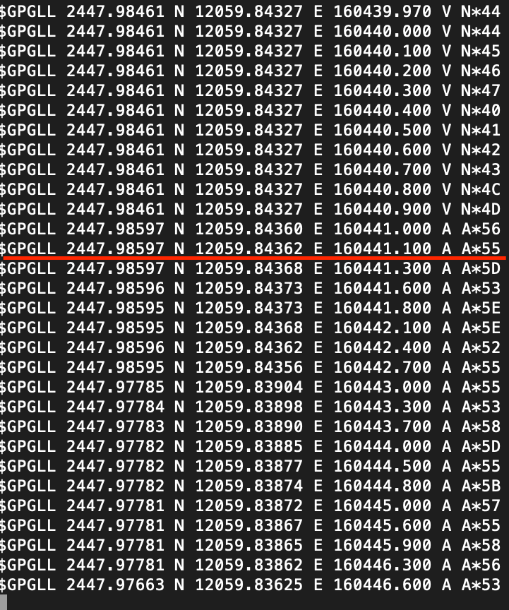

Hi, I can't get the correct fix rate for x-nucleo-gnss1a1
Using following command:
$PSTMSETPAR,1303,0.1,0
$PSTMSAVEPAR
$PSTMSRR
what I expected is update rate 10Hz, i.e., the timestamp is increasing 0.1 each time.
However, the result is
above the red line, one can see that it is updating at the rate of 10Hz
below the red line, it is updating at the rate approximately 3Hz
If I reset the program, it will maintain 10Hz for about 1 sec, then back to 3Hz.
If I power off the stm32 and power on, it will maintain 10Hz for a while, then back to 3Hz.
Any idea or advice will be appreciated, thank you so much.

2019-03-02 9:05 AM
I decide to post it in the reply section since I am facing some problem related to fix rate when using TESEO, if it is better to post a new question, please tell me, thank you very much.
I do success to make fix rate of TESEO run at 10Hz, however, I've immediately noticed that this fix rate is only guaranteed when the GNSS is not valid, i.e., the $GPGLL message informed invalid status ('V'). As long as the GPGLL message is valid ('A'), the fix rate dropped to 2 - 3 Hz.
Despite the result looks totally reasonable to me, but I will still post it here, hoping that I am wrong and someone can tell me what should I do.
Really appreciate for the help. Thank you.

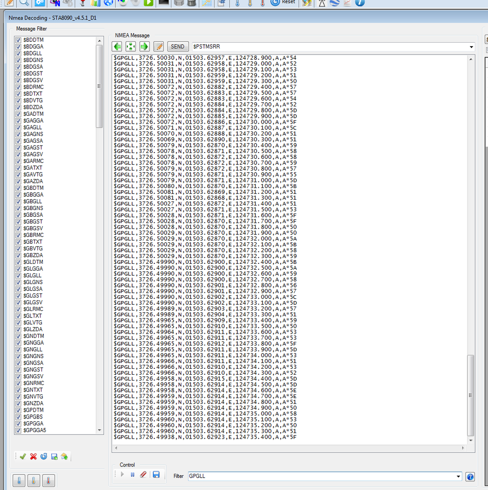

2019-03-04 4:54 AM
Hi
10Hz has to be working with and without valid ('A') field.
I have it working without problem as you can see in the image
I used the scripts provided in the past I also increased the UART-baudrate (115200)
No more than that. May be due to a baud rate too low the systems is skipping message
Let me know
Regards
