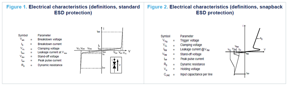

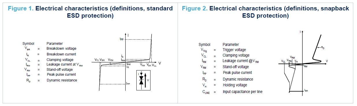

5. What does is meant with snap-back ESD protection?
Standard ESD protections activate at breakdown voltage (called VBR) and their voltage increases with the current linearly to clamping voltage. The snap-back protection instead has a snap-back effect which means that it lowers its clamping voltage after the protection is triggered. The holding voltage (VH) is the lowest voltage when the
snap-back protection has turned on. The lower is the holding voltage, the better is the clamping voltage.
The figures below show on the left the I/V characteristics of a standard ESD protection and on the right the I/V characteristics of a snapback ESD protection.
