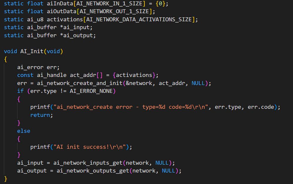

stm32h750 x-cube-ai , ai_network_create_and_init() code stuck
wink
I have already enabled the CRC IP by adding "__HAL_RCC_CRC_CLK_ENABLE();" before "AI_Init();" but still have the log "ai_network_create error - type=51 code=65"
The following is a part of my main.c file

ai_handle network;
float aiInData[AI_NETWORK_IN_1_SIZE];
float aiOutData[AI_NETWORK_OUT_1_SIZE];
ai_u8 activations[AI_NETWORK_DATA_ACTIVATIONS_SIZE];
ai_buffer * ai_input;
ai_buffer * ai_output;
static void AI_Init(void);
static void AI_Run(float *pIn, float *pOut);
void PictureCharArrayToFloat(uint8_t *srcBuf,float *dstBuf,int len);
void Uart_send(char * str);
#define UART_BUFF_LEN 1024
#define ONE_FRAME_LEN 1+784+2
uint16_t uart_rx_length = 0;
uint8_t uart_rx_byte = 0;
uint8_t uart_rx_buffer[UART_BUFF_LEN];
volatile uint8_t goRunning = 0;
  ai_error err;
  /* Create a local array with the addresses of the activations buffers */
  const ai_handle act_addr[] = { activations };
  /* Create an instance of the model */
  err = ai_network_create_and_init(&network, act_addr, NULL);
  if (err.type != AI_ERROR_NONE) {
    printf("ai_network_create error - type=%d code=%d\r\n", err.type, err.code);
    Error_Handler();
  ai_input = ai_network_inputs_get(network, NULL);
  ai_output = ai_network_outputs_get(network, NULL);

Best Regards
3 REPLIES 3
fauvarque.daniel
You probably didn't enable the CRC IP in your application
Regards
  ai_error err;
    Error_Handler();

Best Regards
wink
I have identified the issue, which is that printf forgot to redirect and the PLL settings generated automatically by cubemx are incorrect. These two errors were mixed together and caused
