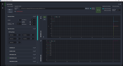

I was trying to reconfigure and customize the HMI given by HSDATALOG2 interface , i have been looking into utilities/HSDPython_SDK/examples ; utilities/HSDPython_SDK/st_dtdl_gui but i can't see how i can manage the controll over the widgets colours and texts .
i' ve consulted the scripts written in python , JSON files but nothing changes while executing the main .
is there a file that contains all the widgets , how may i make my own changements.

HSDPython_SDK is based on wheel packages installed through the provided installer. The source code is also released, and you are free to have a look at it, but the code running is related to the already-packaged wheel. So, you must act in the path where you installed our packages. Where did you install the SDK? Have you enabled a virtual environment before installing the SDK?
If so, the source code to modify is in your virtual environment under \Lib\site-packages\
(e.g., I built the virtual environment called .venv
in the root folder of the SDK, so the code is in \Utilities\HSDPython_SDK\.venv\Lib\site-packages\st_dtdl_gui
). If not, the package has been installed in your system Python home folder.
Widgets are divided into types: there is a file for each kind of widget (e.g., plots are organized into Lines, Heatmaps, Bars, etc.).
