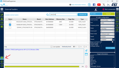

I get the core is locked up in stm32cubeprogrammer while flashing the files. I connected camera correctly.

  4. Check the external loader for N6 (maybe this is your problem
  5. Go to to "erasing and programing"
  6. Flash the 3 .hex files, you should have no errors
