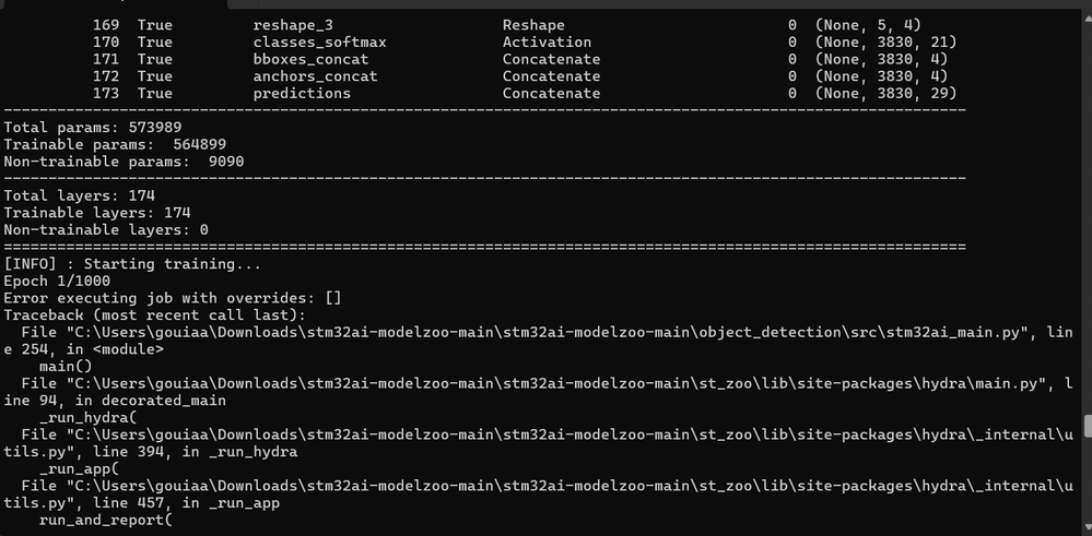

‎2024-09-03 10:12 AM
Thank you for your response.
I tried using Model Zoo, but I encountered the errors shown in the attached figure. I haven't been able to solve them.
Best regards,

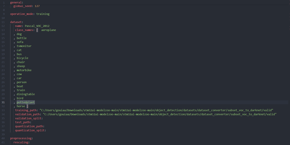

‎2024-09-03 11:22 AM
Can you share a higher resolution picture with the last part of the error ?
Did you try the default yaml file to train the ST ssd mobilenet v1 model ?
You just need to change the dataset section with the path to the dataset and possibly the classes.
Keep the model_path empty has the model will be generated.
Then simply do:
python .\stm32ai_main.py
‎2024-09-03 1:50 PM
Unfortunately, the error still persists. I have attached a clearer screenshot of the error
‎2024-09-03 11:39 PM
It seems your dataset is not loaded properly as you can see 0it in the trace.
Note that the dataset for object detection shall be with the YOLO Darknet format. There are scripts to convert datasets in COCO or Pascal VOC format to YOLO Darknet format in https://github.com/STMicroelectronics/stm32ai-modelzoo/tree/main/object_detection/datasets

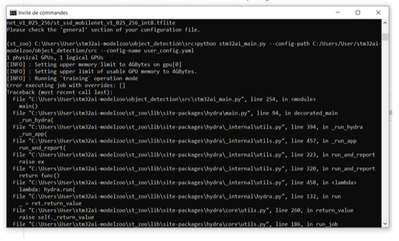

‎2024-09-04 9:21 AM
Thank you for your response. I tried to convert the COCO format to YOLO Darknet format., But I keep encountering errors. Should there be any modifications made in the YAML file or the Python converter file? Attached is a screenshot of the errors.
Best regards,
‎2024-09-04 10:34 AM
With your COCO dataset, on one side you have the images, on the other the annotations as a json file.
A COCO structure is usually as follow:

In your yaml file you should have:
coco_format:
images_path: <dataset_dir>/images/train
json_annotations_file_path: <dataset_dir>/train_labels.json
export_dir: coco_darknet/train
On your log, it looks like the son_annotations_file_path field is missing
Best Regards

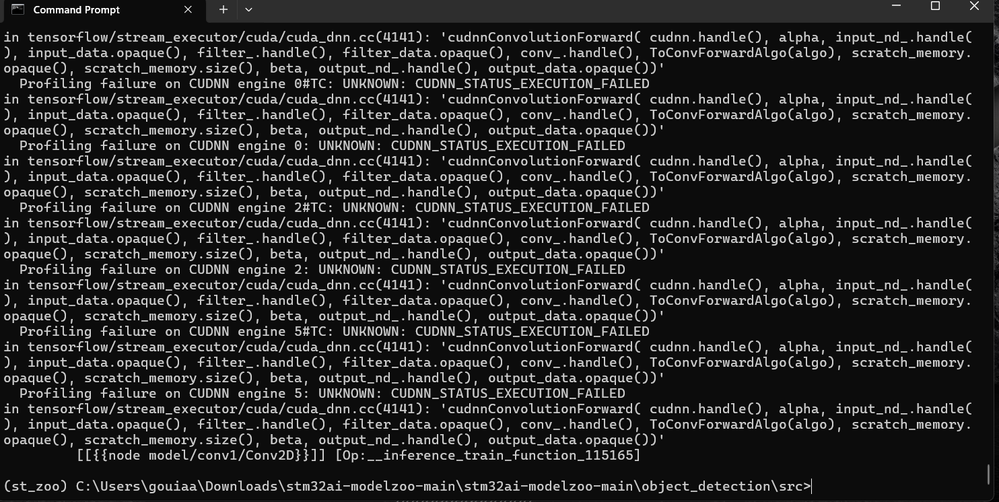

‎2024-09-17 9:16 AM
hello mr ST employee
so i managed to convert the pascal dataset to darknet . but when i tried to train it . i had various errors about CUDNN when i reached the phase of 1/1000 epoque
so do you have any idea how to solve this error??
