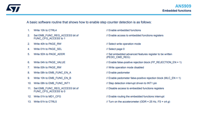

LIS2DUX12 -interrupt used for stepcounter
S1
which are the interrupt used for step counter design
1 REPLY 1
Federica Bossi
Hi @S1 ,
Please refer to section 6.1 of AN5909, you will find also an example about how to implement the step counter:
