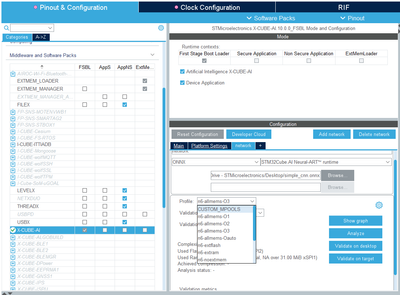

I’m sending this just to make sure that if I want to make the X-cube-AI automatically distribute the model to the external Flash and the internal ram of the STM32N6570-DK board, I need to configure the json file of the AI core based on the real address of the external memory and the internal memory, right?
‎2025-04-22 1:38 AM
Hello @Z-YF,
Yes, I think the best way is to edit user_neuralart.json and add a field for example:
- Copy one of the existing one
- Give it a name: CUSTOM_MPOOLs in my case
- Create a mpool file and set the path on the "memory_pool" line
- edit other things if you want
- Save
"CUSTOM_MPOOLS": {
"memory_pool": "./my_mpools/MY_CUSTOM_MPOOL.mpool",
"memory_desc": "./my_mdescs/stm32n6.mdesc",
"options": "--optimization 3 --all-buffers-info --mvei --no-hw-sw-parallelism --cache-maintenance --Oalt-sched --native-float --enable-virtual-mem-pools --Omax-ca-pipe 4 --Oshuffle-dma --Ocache-opt --Os"
You can find the file here:
C:\Users\YOUR_USER\STM32Cube\Repository\Packs\STMicroelectronics\X-CUBE-AI\10.0.0\scripts\N6_scripts\
Then in Cube AI you can select it:
