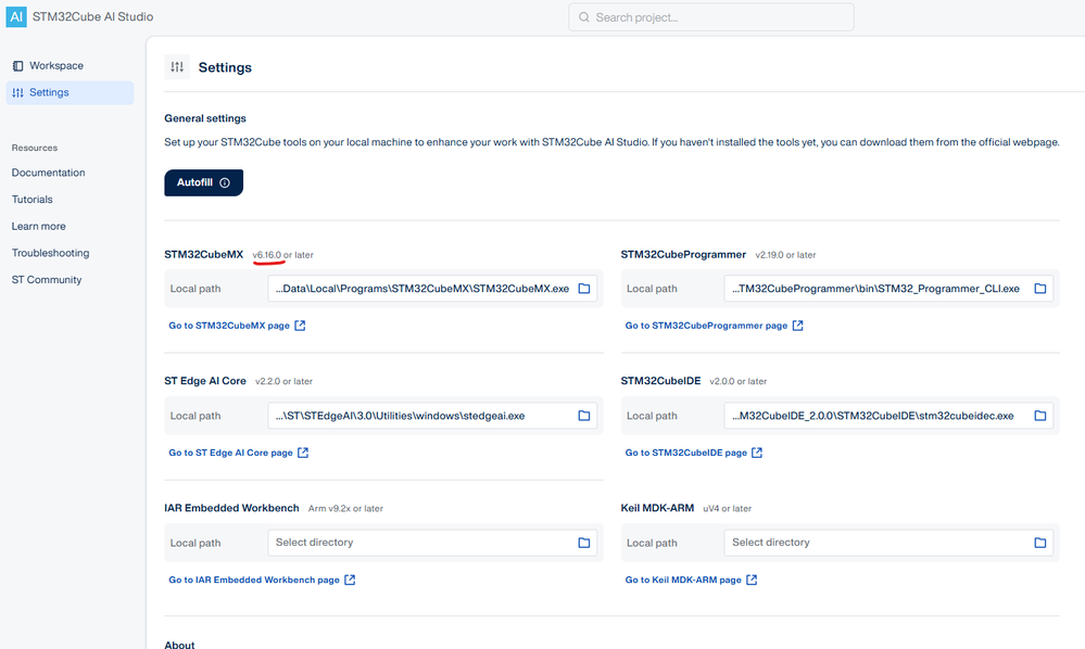

I imported a model into STM32Cube AI Studio and tried to run it in On Target mode, but I encountered an error as shown in the attached file. What might be causing this issue?

Hi @kloudy
Could you try to update your CubeMX please.
Minimum required is version 6.16.0 and CubeIDE to version 2.0.0

Hello @kloudy
As @Julian E. shared, could you please upgrade the version of STM32CubeMX to the latest one ?
Also, STM32CubeMX behavior you experienced is quite abnormal. Are you working in a corporate environment ?
If yes, could you try to set proxy settings, either in STM32CubeMX itself or in your environment ?
You should have a progress bar with a download and unzip procedure, and after that, you should be able to select a board or install F/W packages.
