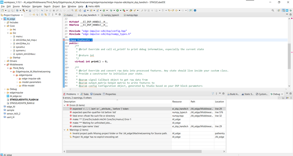

1. AI model generated from edge impulse AI platform for B-L4S5I-IOT01A Board. Package downloaded.
2. CUBE mx generate code for B-L4S5I-IOT01A Board.
3. Edge-Impulse AI Studio package is included in code.
4. Compilation fail happens at ei_dsp_handle.h file
As I made a package from edge impulse for B-L4S5I-IOT01A and started to build its getting errors as in the screenshot.
I already gone through blogs and converted the code into cpp using the option available in cube ide to converts c to cpp. Please help me here.
