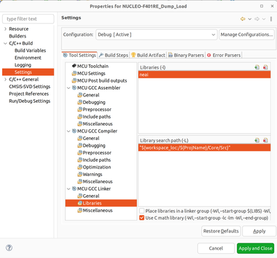

You need to include the library path in the project settings:
  • Right click on your project > Properties
  • Then Click on C/C++ build > Settings
  • Then MCU GCC Linker > Libraries
  • In Libraries (-l) click on the green + icon and type the name of the library without lib (by default the library name is libneai, so type neai)
  • Below in the Library search path (-L), add your path to the library
  • Click Apply and Close
