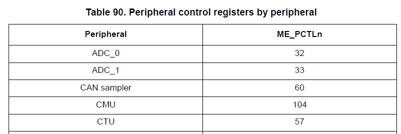

, which apparently means that register 57 is available, and is the right register for the CTU, according to the datasheet:

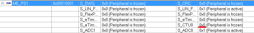

, but cannot verify the actual contents of ME_PCTL57 as there is no such register in SFR View. The SPCSetPeripheralClockMode() executes OK, however looking at the contents of ME_PS1 I can see that the CTU still is frozen:
So my question is, what should be the proper way to enable CTU in SPC56EC74? Another question is why the ME_PCTL57 is not shown in the SFR View?

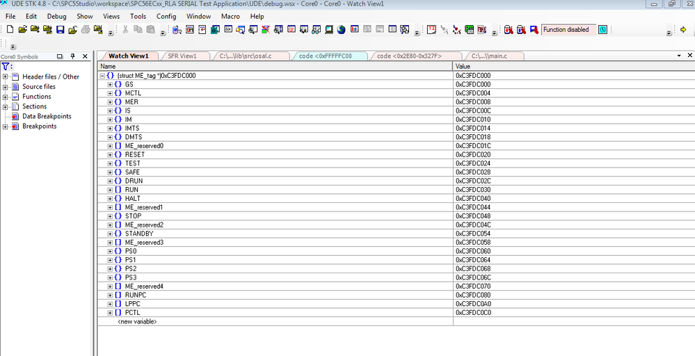

    for the PCTL57 not visible on PLS UDE. it is an PLS issue for SFR View.
    there is a workaround by using the Watch view in casting the good pointer (cf screenshot)
    Best regards
    Erwan
