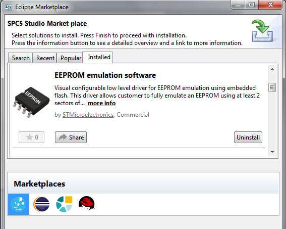

I am using SPC560B540L5 Discovery board and SPC stdutio 5.2.3 updated version code generator.

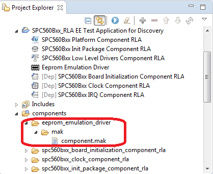

I am trying to emulate the Flash as EEPROM using EED driver. The IDE is installed with EEPROM emulation software and the way I generate the project is also proper even then the necessary configuration files and libraries for EED are not getting generated after generating the code. Normally, it should get listed under the EEPROM Emulation driver in components directory, but nothing exists other than ''mak'' folder. Please find the snap below.

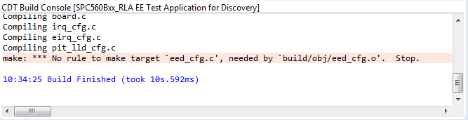

But still I tried to build the project but the compilation failed due to below shown error.

‎2017-03-13 3:22 AM
Hello R. SanthaMurphty ,
The problem has been reproduced on 5.2.3
it will be solvedofficially on 5.3.0.
Anyway, you can install these new eeprom feature by local update
(Uncheck Category)
it solves the issue
Best regards
Erwan

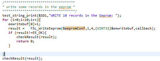

As per my understanding FSL_WriteEeprom writes 10 records each 4 bytes,
I would like to write one byte at a time in a record in this case how to increment to second byte address of the record. As per below code, the second argument of FSL_WriteEeprom is data ID(nothing but record address. If I want to write single byte per iteration what could be the value need to be passed as a second argument to FSL_WriteEeprom.

‎2017-03-20 9:35 AM
Hello Santhamurphy ,
Please refer to the document UM_SPC56xx_C90Flash_EED.pdf(cf document in the component)
if you want to store 1 Byte
i would use :
UINT8 eewritebuf[1];
* write some records in the eeprom *
test_string_print(&SD1,'WRITE 10 bytes in the Eeprom: ');
for (i=0;i<10;i++){
eewritebuf[0]=i;
result = FSL_WriteEeprom(&eepromConf,i,1,(UINT32)&eewritebuf,callback);
if (result!=EE_OK){
checkResult(result);
return 0;
checkResult(result);�?�?�?�?�?�?�?�?�?�?�?�?�?�?�?�?
in EEprom driver , there is no record address.
you should use FSL_ReadEEprom
