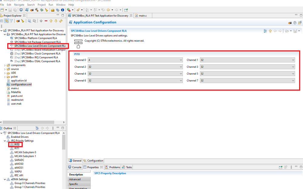

There is an example application in SPC5Studio tools suite :
SPC584Bxx_RLA PIT Test Application for Discovery
the priority is set in Low Level drivers component
You can find all the information in the Reference Manual RM0449

yakdagg
i saw this example but it s not about priorities. i tried change priorities manually from IRQ Priority Settings which you share ss but they're not cutting processes.
as example
task2_{ >10ms timer >IRQ Priority 16
some processes +2ms
task_1{>1ms timer >IRQ Priority 8
counter++
at this scenario, "task_1" should cut "task_2" least 2 time and counter should increase. but it is not working.

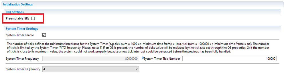

could you try to enable the switch :
OSAL_ENABLE_IRQ_PREEMPTION ?
Best Regards
Erwan
yakdagg
it's default value is FALSE but tried with both option which TRUE and FALSE. unfortunately results are same.
