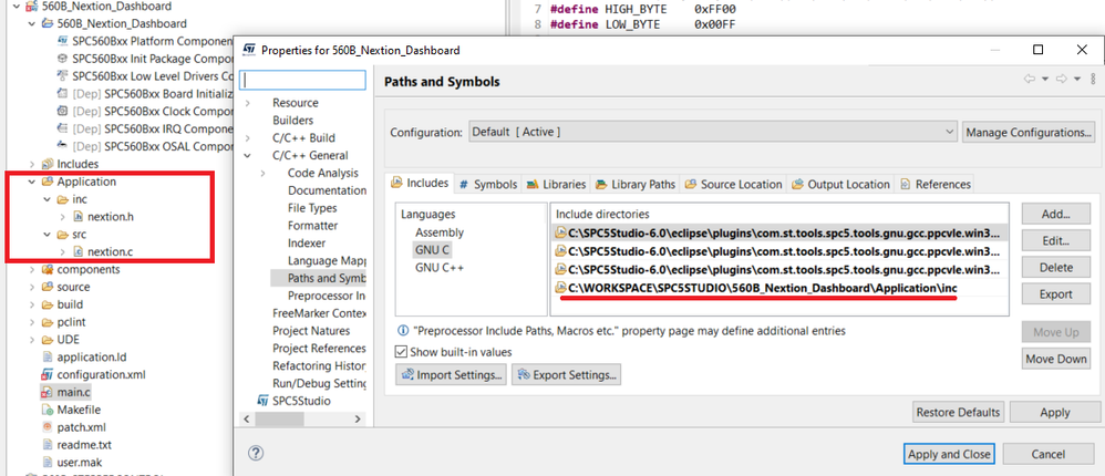

I'm getting a lot of errors in SPC5Studio. If I use it with main.c without separating the library directory I'm working in, I don't have a problem. But when I want to separate the libraries, it doesn't work like an ordinary eclipse. Likewise, I don't have any problems with STM32CubeIDE, but SPC5Studio gives a lot of errors. The errors I get are:
make -j8 all
Compiling main.c
main.c:4:21: fatal error: nextion.h: No such file or directory
#include "nextion.h"
compilation terminated.
make: *** [components/spc560bxx_platform_component_rla/lib/rsc/rules.mk:137: build/obj/main.o] Error 1
"make -j8 all" terminated with exit code 2. Build might be incomplete.
For example, when I write the library I have reserved as nextion.h directly into main, it works. I will share with you the settings I made and the library I created.

Hello ,
SPC5Studio test application does not use CDT Settings.
i recommend to add the include library or source in user.mak. (nextion.c nextion.h)
# List of all user C source files
U_C_SRC     = ./main.c
# List of all user C++ source files
U_CPP_SRC   =
# List of all user ASM source files
U_ASM_SRC   =
# List all user C define here, like -D_DEBUG=1
UDEFS       =
# Define ASM defines here
UADEFS      =
# List all user directories here
UINCDIR     =
# List the user directory to look for the libraries here
ULIBDIR     =
# List all user libraries here
ULIBS       =

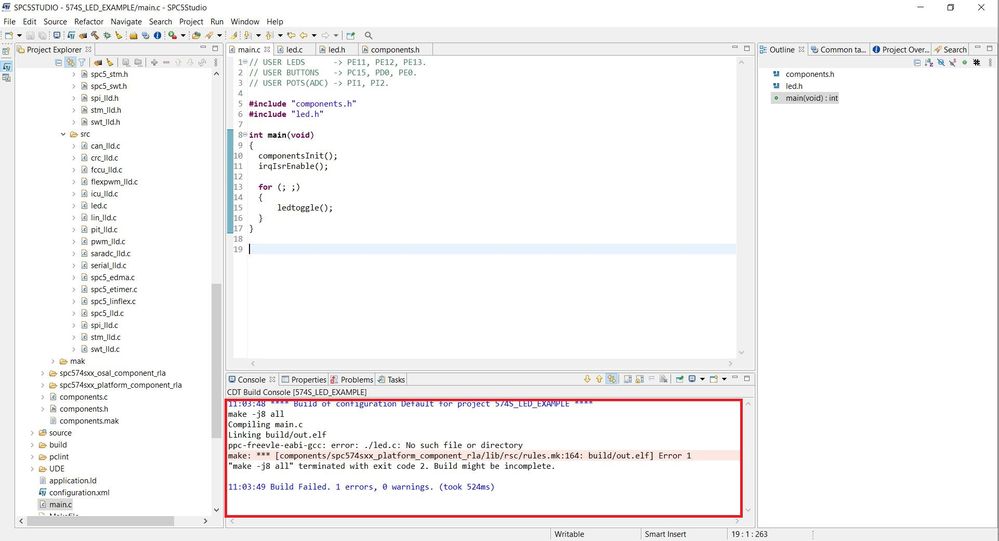

I made the user.mak file as you said, but it still doesn't see the library. For example, I opened a led project and I include it, and I get an error. Can you post a sample project with an external library? Thanks a lot for your support.
