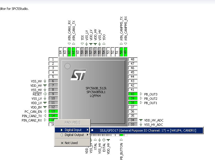

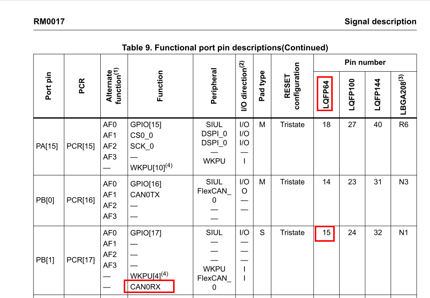

I am configuring pin map for SPC560B50L1. I expect to configure pins 14 and 15 as CANFlex0 TX and RX respectively.
Due to manual, pin 15 is the one for CAN-RX for my 64-pin UC:

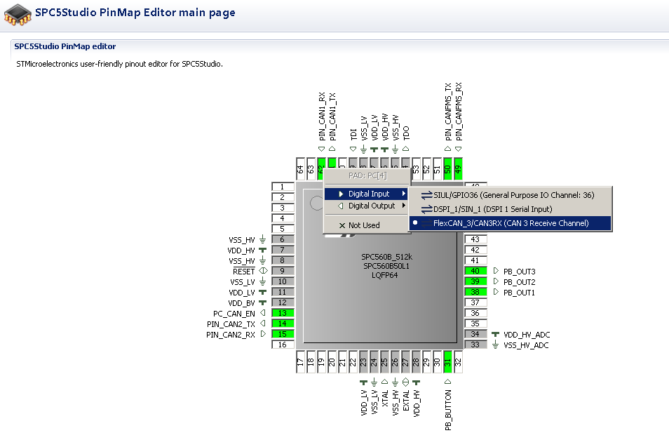

But this pin has no other option to select than SIUL/GPIO17:
For another CANbus (CANFlex3) there is an option CAN3RX for the pin 62, so I think it is a bug of SPC5Studio, isn't it? Or am I doing something wrong?

Erwan YVIN
hello ,
It is not a bug.
For PB[1] , CAN0RX is an intrinsec function .. you have to set in Digital Input.
Best Regards
Erwan
