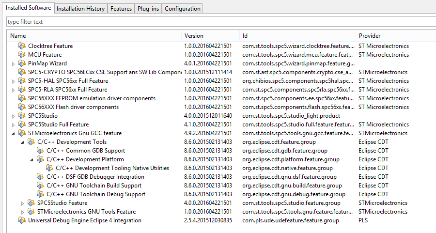

sebastian239955
Posted on April 27, 2016 at 11:20
Hello Erwan,
I'm using
after uninstalling and reinstalling freegcc 4.9.2 the previous errors are gone.
My install looks like this:0690X00000604toQAA.png
After cleaning and regenerating, I get the following errors when compiling:

Erwan YVIN
Posted on April 27, 2016 at 11:46
Hello Sebastian ,
Your installation is correct.
but your boot.s is still the old one after regeneration.
your clean procedure is not ok.
did you use clean procedure by Activity Wizard ?
(cf screenshot)
you can remove by hand your components directory in your application
Best regards
Erwan
