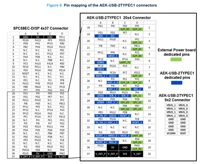

Read this data (Hello Worl) from TX RX pins of SPC58. with USB to TTL module.
A1 - GND
D1- TX
A10- RX
