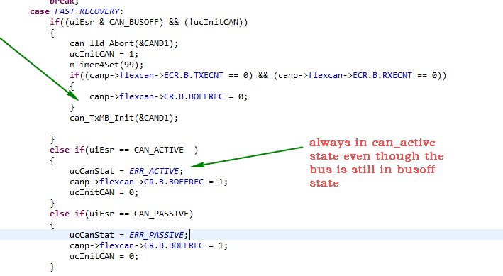

hello guys:
      I am using the flexcan module of spc560p, now I want to use the abort mechanism to recover the can bus from busoff state by software instead of by the hardware automaticly,because the  hardware recovery  is too fast,
So I enabled the AEN bit in the MCR,when I captured the busoff in ESR register,I began to abort the TX MB by set the CS CODE to 09, and then activited the TX MB by set the CS CODE to 08,and then  send the message,but there was no message had been sent out,and the can bus was still busoff,there was no waveform in the can bus ,I‘ve seen the manual  several times, but I am not clear about how to recover from the busoff state by software?If any of you have the answers,I will be very appreciateï¼�

    I suppose you set  BOFF_REC bit in CTRL register to 1 in order to avoid automatically recovery.
    Anyway you can use this bit during execution when catching a bus off interrupt as reported below.

    wang mengmeng
    May 17, 2018 8:13 AM UTC
    Posted on May 17, 2018 at 08:13
    Hello
    Procolo:
    Thanks for your help! I have got the description in the manual, but there is another problem that how can I know that the
    128 sequences of 11 recessive bits have been detected, I checked the manual and found the description about the ECR register in busoff state,shown as below:

    So I learnt that if I want to recover from the busoff state by software, I need to assert the
    BOFF_REC
      first, and when the Flexcan enter the busoff state, I need to monitor the Tx_Err_Counter and Rx_Err_Counter, if both of the err counters reset to 0, It can be concluded that the 128th occurrences of 11 consecutive recessive bits have been detected, and all I  have to do is set the BOFF_REC
     bit to 0. Is that right?

    Hello Mengmeng,
    Yes you're right but you should also check FLT_CONF  in ESR register which will be set to error active (00)
    when can is in bus off the tx counter reaches 128.

    Hello procolo?
          Actually, I don't quite understand about what you said about the
