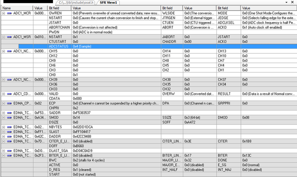

Posted on April 04, 2014 at 22:05
Hi Erwan,
no, this doesn't solve the problem. As you can see in the screenshot, acd is still sampling, even after 20s and no adcBuffer is written. I don't know where I have to search.
Concerning the channel 44: my reference Manual shows PB12 as ADC1_S[12] and on the image on Page 656 (Doc ID 16886 Rev 6) there are ADC1_S[0] (Ch 32)... ADC[12](Ch 44).

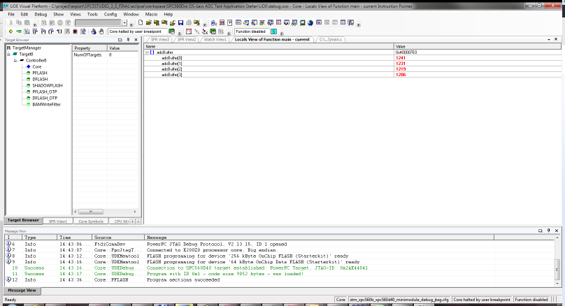

Erwan YVIN
Posted on April 07, 2014 at 16:56
Hello Stefan ,
i am sending my test application by attachment.
Could you send me your test application ?
i do not reproduce this issue cf screenshot

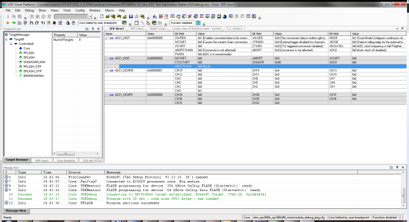

I copied your settings to my Project and got the same Problem. The ADC1-registers have the same values as on your screenshot, but ADC stays sampling.
