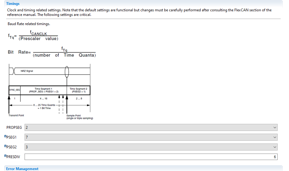

my board is the SPC560DL1, i understand the the flexcan uses Perphial set 2 clock so mine by default is set to 24Mhz.
i've attached images of my settings and results

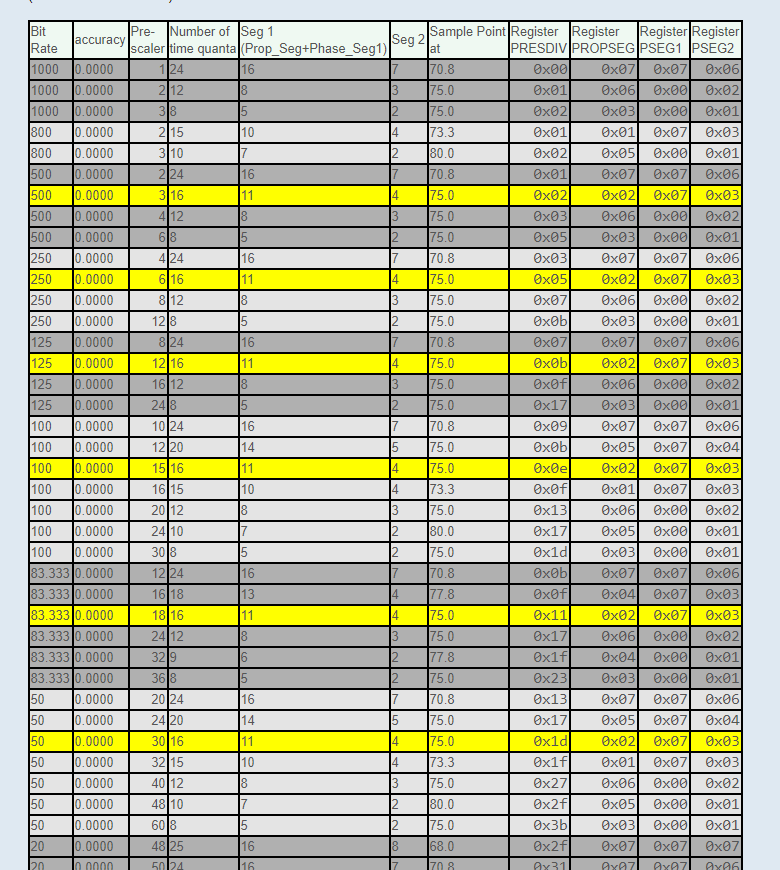

http://www.bittiming.can-wiki.info/#Freescale
here is the table i've created with < 24Mhz, 75% sample point >
my settings for 250 are
sample point @ 75%, i've also tried 87.5
Pclk 24Mhz
propseg= 2
pseg1 =7
pseg2 =3
presdiv =6
which should solve to 24,000,000/6 = 4000000
4000000/16 = 250 baud

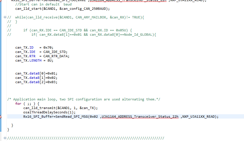

Here is my code snippit that i'm using to test can functionality

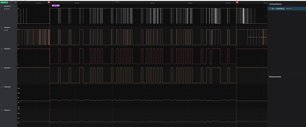

data on my output looks like this
with my analyer it's seeing garbage on the decoder side so im guessing the timing is incorrect

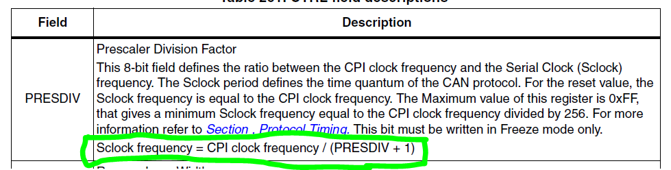

‎2020-11-19 1:00 AM
the issue is in your configuration.
the formula to calculate the clock is:
PCLK / (PRESDIV + 1)
So, in your configuration PRESDIV has to be set to 5 (and not to 6)

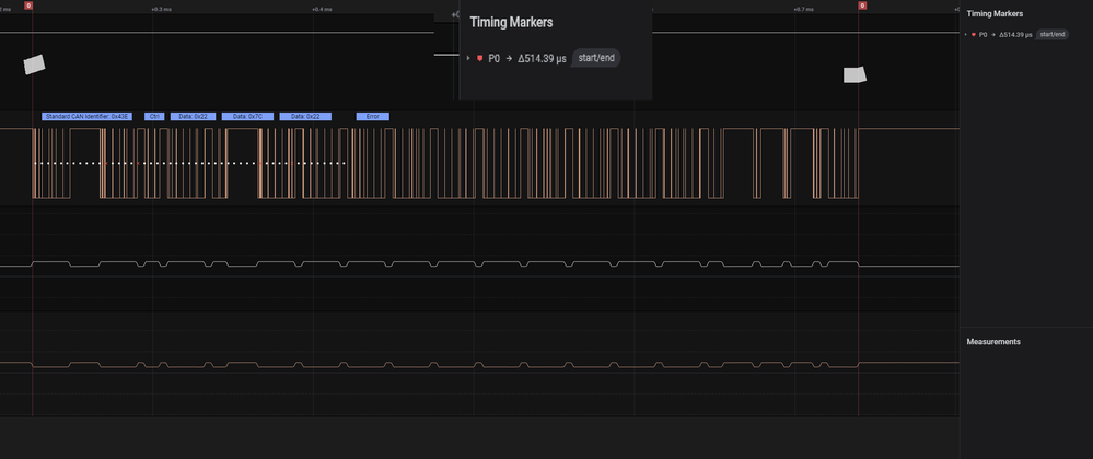

‎2020-10-18 4:11 PM
Hey Erwan,
here is an attached image, the data constantly changes along with everything else but here is one that had more data than the rest and with a timing marker as well.
Setup:
The actual id is 0x70
8 bytes of data where the message is 0F 00 00 00 00 00 00 0F
I've also attached the file with the entire can recording ( program is logic 2 from salaeae) , also added in the timing for the start and end.

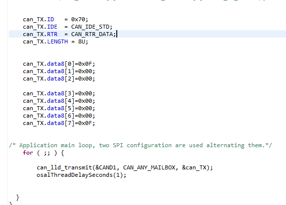

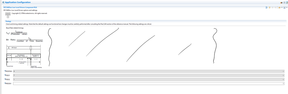

‎2020-10-18 4:16 PM
attached image of setup code, adjusted since the original post

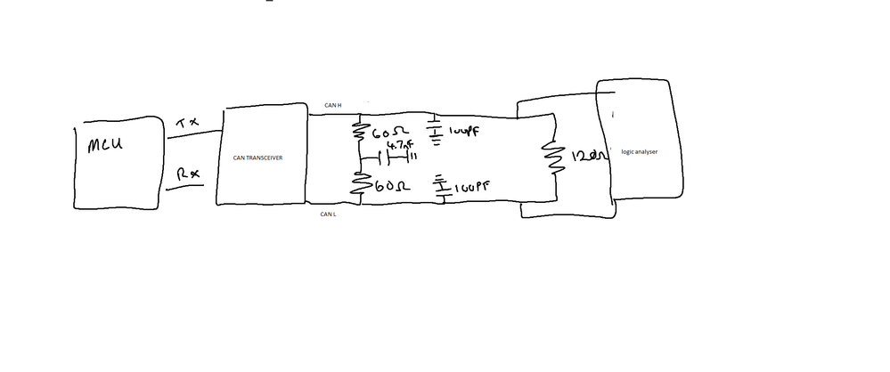

‎2020-10-18 4:54 PM
Here is also a setup using the mcp2551 with just 2 120 ohm resistors at each end
the data in this message should be different to the prior as this is on my spc560d-dis board
channel 2 and 3 are connected to TX and RX
Edit: had accidently marked vdd to be gnd

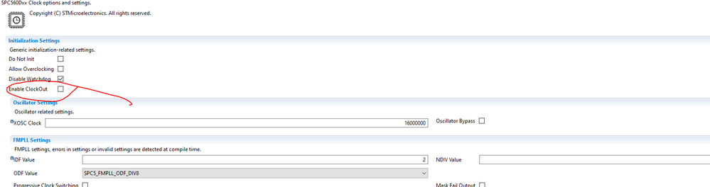

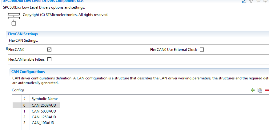

‎2020-10-20 7:58 PM
Hey Erwan, i found out that beyond 20kbps the can signal becomes unstable.
i was told that i should be using the external clock to which i've tried enabling but when i do it results in a system reset.
is there a process to enabling the external clock ?
these also some boxes like enable clockout that i dont quite understand what it exactly does.
a guess would be that you would need to tick it along with the bypass clock but in doing that i still get an unexpected reset.
on my board i have the the CSTNE16M0V53C000R0 (16Mhz) which is advertised to be an alternative to the one used in the spc560d disc board.

‎2020-11-19 6:28 PM
