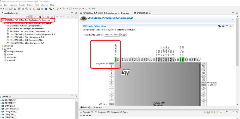

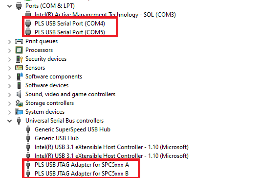

I have SPC5-UDESTK plug in to SPC560B-DIS board and i have activated VCP but still not connect.
If I use onBoard debbuger works, but i need to work with external SPT5-UDESTK to program my custom board, and indeed not work.
Any idea?
Thank you in advantage

if debug is working , PLS FTDI Driver is well installed.
Please Check your device manager if you can see the COM PORT when VCP is activated (cf screenshot)
then check with Test Application provided by SPC5Studio
LIN0TX and LIN0RX should be installed.
