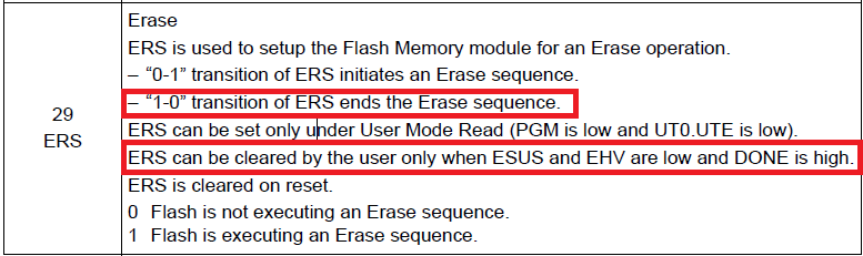

The PEP flag (of FLASH_0.MCR) should be set when I try to write to protected block of flash.
I observe, that this flag is cleared automatically at the moment of clearing EHV flag.
Is it intended and should be written in RM? Or do I do something wrong?

Could you check if you respect the transition ?
Have you unlocked the flash ?

Of course I have not unlocked the flash, because I am testing the PEP flag, not ERS. My purpose is to report failure due to attempt to write or erase locked flash.
I have discovered that I need check read PEP flag before I clear EHV. Otherwise PEP gets cleared as soon as I clear EHV. Afterwards I can't check why flash write/erase failed.
I'm finding this ambiguous: manual says that I have to clear this flag before another flashing, but this never happens, because UC clears PEP itself.
