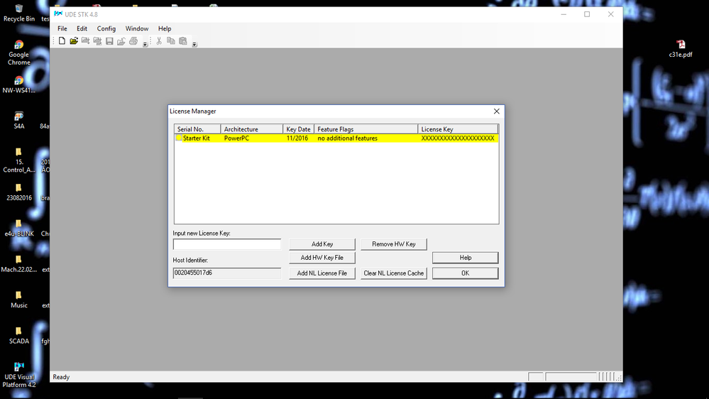

Hi all, I have SPC56P-Discovery and I have setup UDE Visual Platform 4.8.
But I'm not add key.
Need for help!
Thanks
#spc5studio #plsSolved! Go to Solution.

Hello ,
The key is available is this website
https://www.pls-mc.com/ude-starterkits/features-a-1020.html
Part : SPC5xx SPC5-UDESTK-EVAL Starterkit
The SPC5-UDESTK-EVAL version works only with the
SPC5-UDESTK JTAG/USB adapter for SPC5xxx(SPC5-UADSTK) as communication interface via USB.
anyway , without key , you can download some firmware via USB/FTDI
Best regards
Erwan
