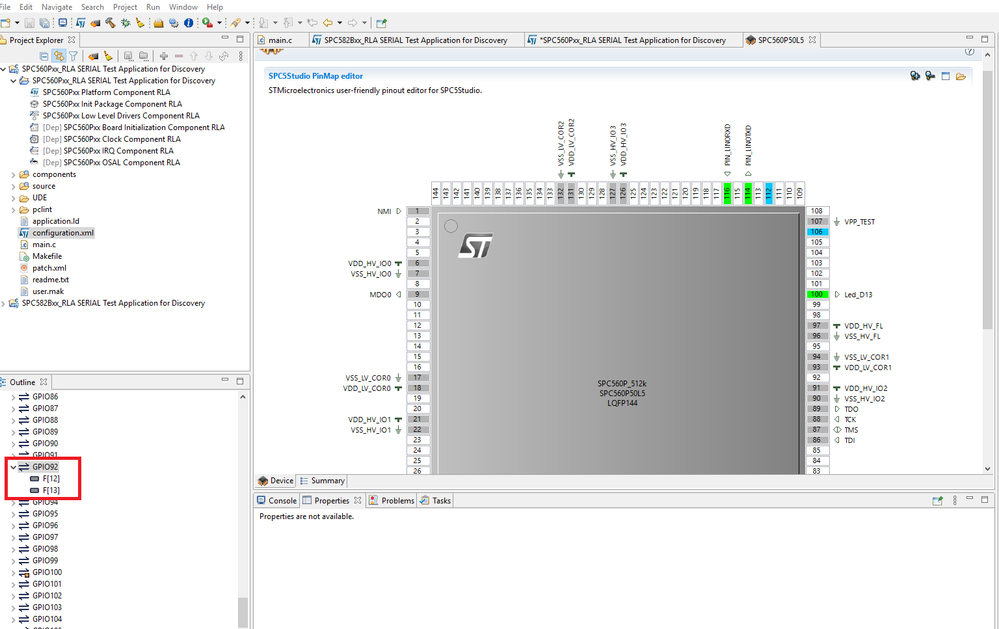

Hi Technical team.
I want to configure both F12 and F13 as input pin.
When i am trying to configure F12 and F13 as input pin in PinMap Editor , it gives error (attached the error screen).
I tried this on sample project "SPC560Pxx_RLA SERIAL Test Application for Discovery".
Hardware used : SPC560P Disp
Please suggest me your ideas to solve this issue

Yes ,
You have tried to configure F[12] and F[13] to the same GPIO
cf Screenshot and reference manual
Best Regards
Erwan

From above conversation, My understanding is below,
Port F12 and F13 are not available to configure/use as GPIO pin at the same time in the application
We can use/configure either F12 or F13 only as GPIO at the same time .
is my understanding correct?
or
If my understanding is not correct, Please provide the procedure to configure both F12 and F13 pins as GPIO in SPC5Stusio.

Hello Ratheesh ,
Cf reference manual,
It is not possible to configure F12 and F13 with the same function (Ex: GPIO92).
