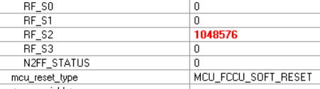

2022-03-24 8:00 PM
Dear ST,
I am also developing the FCCU function by SPC58EC80. I can read the reset cause by RGM.FES as FCCU(MCU_FCCU_HARD_RESET or MCU_FCCU_SOFT_RESET), but my goal is to read which fault channel source of FCCU caused the reset. So far, I haven't been able to achieve my goal.
my step is read register RF_S and N2FF_STATUS of FCCU at main function startup, just like this:
FCCU.CTRL.R = FCCU_OP10;
while (FCCU.CTRL.B.OPS != 0x3) //0b:11 Successful
asm("nop");
FCCU_Log->RF_S0 = FCCU.RF_S[0].R;
FCCU_Log->RF_S1 = FCCU.RF_S[1].R;
FCCU_Log->RF_S2 = FCCU.RF_S[2].R;
FCCU_Log->RF_S3 = FCCU.RF_S[3].R;
FCCU.CTRL.R = FCCU_OP6;
asm("nop");
FCCU_Log->N2FF_STATUS = FCCU.N2FF_STATUS.R;
i use debugger mode and set breakpoint at this, when reset by FCCU(such as channel #8 reset reaction), the register RF_S and N2FF_STATUS always 0,just like this:
becase i use channe #8 as the test, so i think RF_S0 should be 256. The facts did not meet expectations。
Please help me,thanks !
