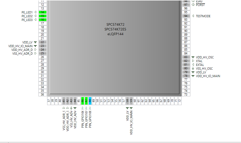

How to programme adc for spc574k74e5, there is no clear example. I am not able to program saradc to any other pin than given example!
Ah.2
0693W00000DlqbKQAR.pngSARADC has been configured for PIN_GPIO106 and PIN_GPIO107 not able to configure for PIN_GPIO108
Gui configuration has been changed , SARADC channel has been enabled and Pin function has been set.

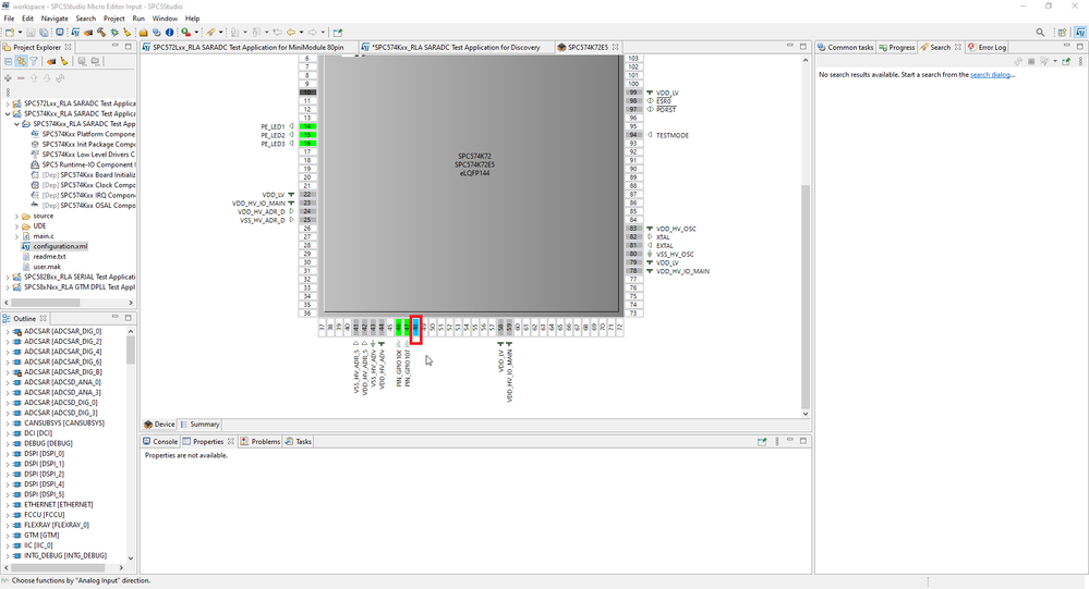

0693W00000DnLL2QAN.pngHello ,
in this application :

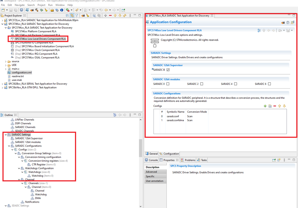

SPC574Kxx_RLA SARADC Test Application for Discovery
you can set the PIN48 for ADC and update ADC low level drivers in configuration
0693W00000DnM4ZQAV.png Best Regards
Erwan
