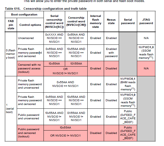

I have two applications Bootloader and main application. I'm using UDE STK4.10 to program the board.
I want know How I can load bootloader with out erasing the Main application flash memory and same for the main application write. while updating application how i can protect my bootloader code from the erase process.

you should check the Boot Assist Module (chap 35) and to have a correct linker file.
You can check Censorship Table in order to censor your flash
Take care ..because you can lockout your chip
Best regards
Erwan
