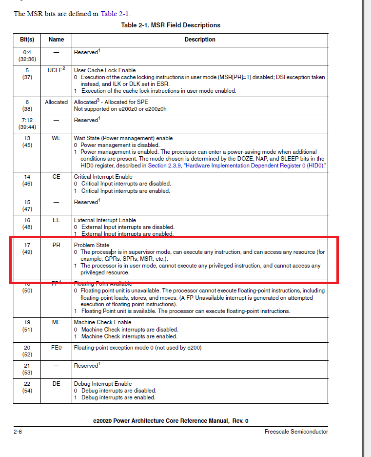

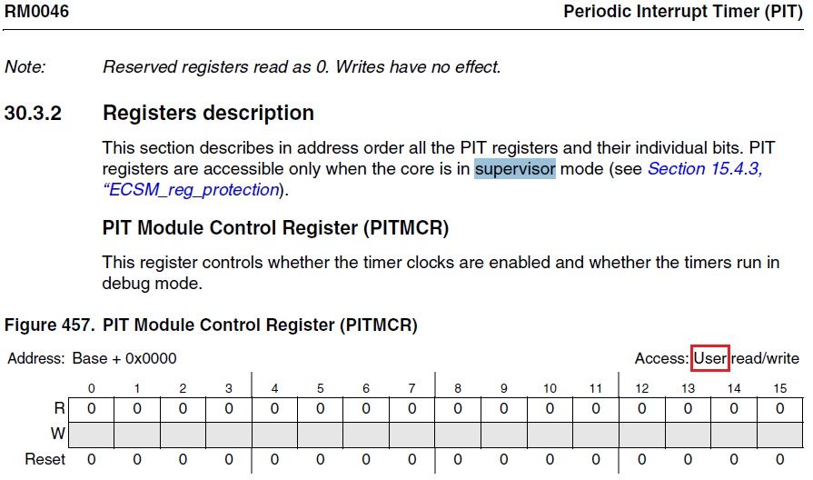

PIT registers are accessible only when the core is in supervisor mode. How to go to the supervisor mode?

Ok the RM is not clear. Ithink you could access in Normal mode.
SPC56 and MPC56 , weare using the same core e200z0
https://community.nxp.com/thread/358090
you can find some infos in e200z0RM.pdf (e200z0 Power Architecture)
in some cases, it is transparent.
