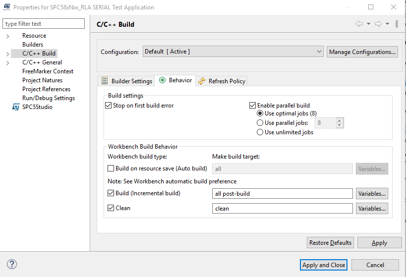

How to add postbuild steps file like srecord (like stm32 Ide) with spc5Studio?

actually the generation of S-Record format is already available in SPC5Studio
and is enabled by default.
Check the build directory and look for ".mot" files.

Hello ,
you can add some post-build options in the properties in the project
do not forget to update user.mak
html: real-html
	do-post-build-stuff
pdf: real-pdf
	do-post-build-stuff
txt: real-txt
	do-post-build-stuff
