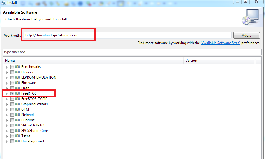

How do I include the FreeRTOS component into my project using SPC5 STUDIO?
TheOtherMarcus
I have looked around in the GUI to see if it can be included anywhere, but I am not able to figure out how to do it. I found the example projects which have the FreeRTOS component so I guess it must be possible to do in some way.

Erwan YVIN
Hello ,
Sorry for the late answer
You can download the component by using the update site mecanism on http://download.spc5studio.com
the Demo application will be displayed on the Application Wizard
and you will be able to add the freertos component in your current application.
best regards
Erwan
