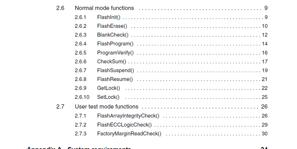

Hi my deer friend
you are right spc studio has a lot of example like you mentioned it but unfortunately read function isnt one of them.
I send you a list of function that work in flash operation0693W000008xBi9QAE.pngas you can see in UM1627 user manual and this pic there isnt read function.
I try pointer solution to get read flash but it doesnt work.
I am waiting for your answer
thanks a lot man
